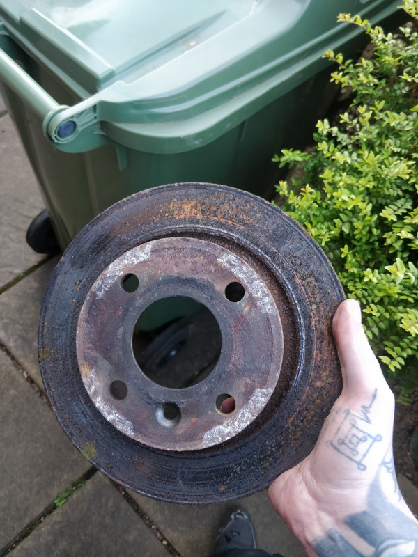

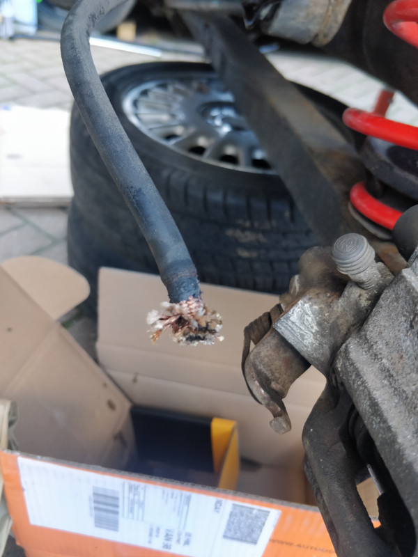

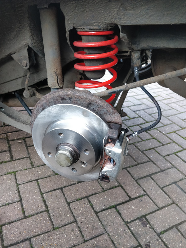

After a bit of delay bcoz of shipping (bloody Hermes) I finally got all the rear breaks redone yesterday, new disks, calipers, pads, hand break cables and break lines! Just in time for the mot today!
Found out the break imbalancing was due to the bolt that's on the caliper you take out to be able to adjust the break was rounded off so much it was a perfect circle so one side couldn't be adjusted πŸ˜‚ had to chuckle
Also Wasn't gonna do break lines but in trying to remove them from the old caliper using a bit of fire one of them exploded πŸ˜‚
Also wasn't going to do disk at first but they did look a bit past it too πŸ˜‚Image
But all's done now and passed it's MOT :D

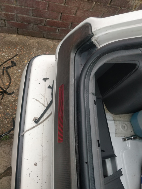

New rear light seels from jifflemon turned up at my parents today so car seats went back in the car to go for a drive to "nanny's in the racecar" as my eldest says πŸ˜‚
Onto changing the seels, cut out the silicone I originally put in and went about pulling the cluster out and honestly why anyone thought it was a good idea to stick the bloody thing in with some black tar crud is beyond me😩
Eventually got it cleaned up tho and new seels in! Just gotta wait for some rain to see how well they work πŸ˜‚

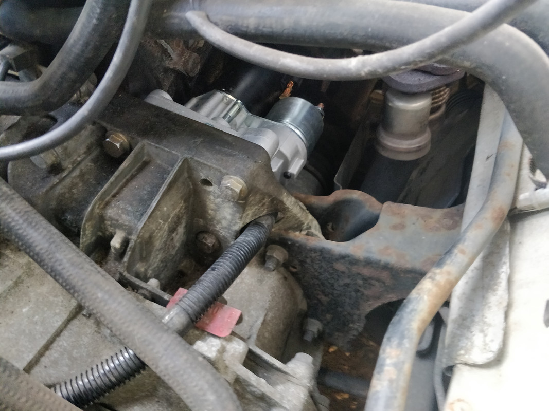

But after work I drove over to the inlaws to pick up the kids, drove there fine, parked up was literally out like a minute, came back and the car didn't start, all that was happening was the electrics turned on but no starter
So whipped out my trusty screwdriver and bridged the starter and sure enough it made some whizzing noises but refused to engage so looks like I'm going to be ordering a new starter for the weekend 😩

Well the new starter turned up today so went about putting that on but out of curiosity I thought I'd try start the car up again and obviously it started up first time πŸ˜‚
So not actually sure why it decided to play dead before πŸ€·β€β™‚οΈ
Still put the new one in though just in case it was the problem and coz I've bought it now πŸ˜‚
